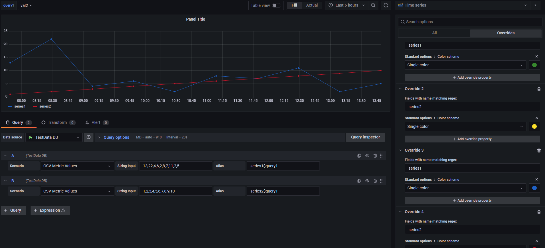

Here’s a possible solution. It’s sort of a hack, but it might work for your use case:
  1. Create a custom variable with the labels “val1” and “val2”.
    Note that val1 : ⠀, val2 : ⠀⠀ is a list of two key : value pairs, where the value for “val1” is Unicode character U+2800 (blank space), and the value for “val2” is just two U+2800 characters. This is just so they’ll be “invisible” in your legend, but Grafana will not treat them as whitespaces.
  1. Change the alias for your data sources so they’ll include the variable, something like “series1$query1” and “series2$query1”.
  2. Create an override for each series and each variable value. Give each specific combination the specific color that you want:
Note that the values in the “Fields with name matching regex” inputs contain the invisible characters.
This gets you the following, where the colors of the 2 series change from green-yellow to blue-red, depending on the selection of the query1 variable:
