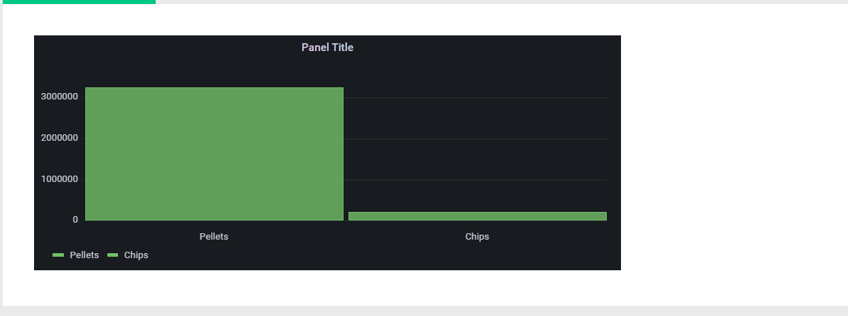

I have embedded the Grafana dashboard into my website and it’s working fine but my issue is, it is not showing the filters on my website. I will add a screenshot so for easy understanding. See below image, these filters are not visible in embedded object.
Embedded Object
