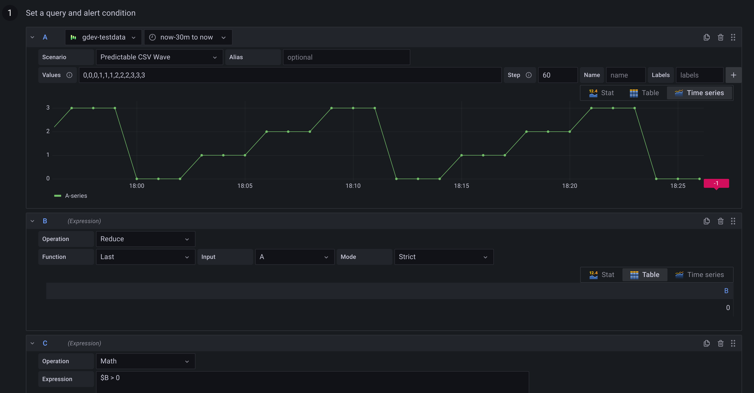

Hi @mjacobson
This is also new to me. So in my case (still using v9.2), I currently have this…
which fires alerts when $B is above 25.0.
If I wanted to apply the severity label as you outlined to fire the alert when the alert goes above 20, 25 and 30, how would I do that? Like this? How should I modify Expression C?

The above was a copy/paste error on my part. In reality, it would be something like this:
severity={{if gt $values.B.Value 20.0 }}low{{else}}warning{{end}}
severity={{if gt $values.B.Value 25.0 }}medium{{else}}warning{{end}}
severity={{if gt $values.B.Value 30.0 }}high{{else}}warning{{end}}
But I still do not know what I would do with expression C (which is $B > 25.0), and how that relates to the custom severity labels.
