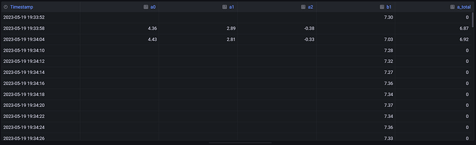

I have four signals (a1, a2, a3, b1) that I am visualizing on Grafana in a single Timeseries panel. Signals a1, a2, a3 are sampled at one rate (say, once per minute), while signal b1 is sampled faster (once per second). I am using Transform → Reduce Row —> Total(a1,a2,a3) to sum together the first three signals (call this a_total). However, the transformation gets evaluated at all timepoints, including those of b1. At the timepoints of b1, the signals a1,a2,a3 have no value, they are missing. The transformation Total result at these “b1” timepoints is 0, which is not correct. This breaks the visualization as now most of the points are 0.
Is there a way to replace the incorrect “0” values with NaN? Or alternatively, a way to filter the resulting transformation to remove 0 values?

The output I showed in the table above: the outputs for the a0, a1, a2, and b1 signals are correct. Signal b1 has a faster sampling than a0, a1, a2. This is expected and intended. The problem is that the transform on a0, a1, a2 is filling in 0s for rows where the a0, a1, a2 are missing, rather than filling in missing or NaN values.
The result I want is that the timeseries visualization for a_total only has points where the inputs a0, a1, a2 have non-missing entries, instead having 0s for all the rows where the inputs are empty. I’d like the visualization to have both a_total and b1 on the same plot.
I tried to experiment with Value Mappings, but I’m not sure this solves the problem. I can change the “0” value to have some text output, like “test1,” but this doesn’t change the timeseries visualization (it just replaces 0 on the y-axis with the string “test1”). Can Value Mappings remove the 0 values? It seems to just replace them with something else, with no real change to the output.

Thanks grant2 - I find that using “Filter Data by Values” to remove a_total==0 entries will remove the entire row where a0,a1,a2 are missing, including removing the b1 entries. I don’t want to remove b1 entries, just a_total==0 entries
