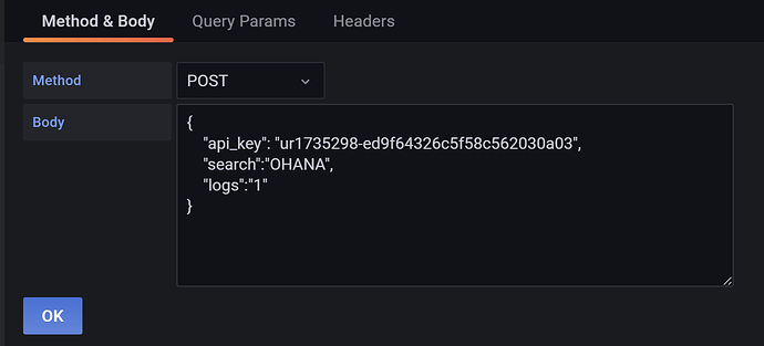

I use a REST API from UptimeRobot through the infinity datasource.
I managed to get the result I wanted :
My problem is that I have to do one request per line, even if all the data I need is in one request.
In the JSON I get from the API, there is my 5 monitors, with different data for each.
In this data, there is a table called logs containing the timeline data.
The only way i managed to make the timeline work is by setting the monitor[i].logs as rows/root.
But by doing so, I can’t access the data from my other monitors and I have to repeat my query.
Is there any way to do what I want without repeating the query?
I don’t think I can put several values in the rows/root field, or display the timeline without setting my logs table as rows/root.
I want to expand this graph to more monitors but it doesn’t seem reasonable if I have to do one query per monitor.

Could you please post the json data coming back from getMonitors?
Hi yosiasz,
thanks for the extremely quick response.
here is the json :

Here is a valid JSON.
thanks a lot for all your help.

Wow, thanks a lot for this, i will try it asap.
I have been trying to make it work with UQL and jsonata.
The input of the timeline should be logs.startdate and logs.type for each monitor.
This allows me to show up/down time sequence for each monitor.
but I don’t know how to structure my data with JSONata so that the timeline panel understands it.
I’ve been using this : JSONata Playground - Get familiar with the JSONata language to try and structure the data.
I ended up with this : schema.meta.custom.data.monitors.logs.[datetime,type]
but this still won’t be accepted by the panel.
I am really gratefull for your help.
Which data points do you want to plot and what kind of visualization?
I do not see
logs.startdate
I want to use the state timeline visualisation to display the on/off timeline of my monitors.
the input needed for that are logs.datetime (start of each state) and logs.type (value of each state) for each monitor

My real remaining problem is that I used inline source with the json I provided you.
And I did that because when I switch to UQL type query, the query doesn’t seem to take my arguments into account properly.
Here is what I mean :
with json type query, the arguments are applied, i get monitors with ohana in the name, and the logs
but when I switch to UQL type query, I can’t get it to take the arguments into account
I have tried putting in my arguments as query params tab or as body of the request, nothing seems to work.
Any ideas as to how to solve this?
Thanks a lot for all your help!

I have tried this :
and that :
i will try with the settings tab you pointed out.
What you have looks like url encoded query. check this out
Thanks for your help!
I tried putting the arguments in the data-source definition as suggested but it’s not working either.
I tried adding them to the headers to just to be sure and it won’t work either.
I am quite stunned by the difference in behaviour between json-format queries and uql-format queries. Do you have any explanation for this difference?
